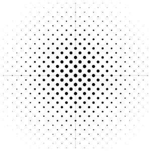

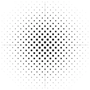

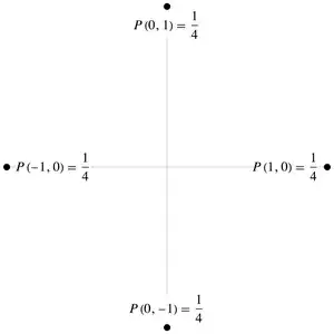

Convolution
The distribution of the terminal position after $n$ moves is an $n$-fold convolution of the distribution of one move. In $2$ dimensions, this is:
In any dimension, odd $n$ distributes the probability to points whose coordinates have an odd sum (the origin is therefore not included). For example, in $2$ dimensions, for $n=63$:
In any dimension, even $n$ distributes the probability to points whose coordinates have an even sum (the origin is therefore included). For example, in $2$ dimensions, for $n=64$:
In the last two diagrams, the area of the dot is proportional to the number of paths ending at that location.

Normal Approximation
In $\mathbb{Z}^d$, the variance of one move is $\frac1d$. Thus, the variance after $n$ moves would be $\frac nd$. Therefore, the normal approximation would be $$ \left(\frac{d}{2\pi n}\right)^{d/2}e^{-\frac{d}{2n}|x|^2}\tag4 $$ Since the distribution is concentrated only on points where the sum of the components have the same parity as $n$, the distribution should be doubled on those points and zeroed out on the others: $$ \bbox[5px,border:2px solid #C0A000]{\left(1+(-1)^{n-|p|}\right)\left(\frac{d}{2\pi n}\right)^{d/2}e^{-\frac{d}{2n}\|p\|^2}}\tag5 $$ where $\|p\|^2=\sum\limits_{j=1}^dp_j^2$ is Euclidean length.
Comparison of the Approaches
$\boldsymbol{n=20}$, $\boldsymbol{d=3}$, and $\boldsymbol{p=(4,2,6)}$:
Formula $(3)$ says the number of paths is $383669852280$ out of the $6^{20}=3656158440062976$ possibilities, giving a probability of $$ \frac{383669852280}{3656158440062976}=\color{#C00}{0.00010493797}\tag6 $$ Formula $(5)$ says that the probability is approximately $$ 2\,\left(\frac3{2\pi\cdot20}\right)^{3/2}e^{-\frac3{2\cdot20}\left(4^2+2^2+6^2\right)}=\color{#C00}{0.00011062678}\tag7 $$ $\boldsymbol{n=50}$, $\boldsymbol{d=2}$, and $\boldsymbol{p=(5,7)}$:
Formula $(3)$ says the number of paths is $3695801675367562256810160000$ out of the $4^{50}=1267650600228229401496703205376$ possibilities, giving a probability of $$ \frac{3695801675367562256810160000}{1267650600228229401496703205376}=\color{#090}{0.0029154735}\tag8 $$ Formula $(5)$ says that the probability is approximately $$ 2\,\left(\frac2{2\pi\cdot50}\right)^{2/2}e^{-\frac2{2\cdot50}\left(5^2+7^2\right)}=\color{#090}{0.0028983731}\tag9 $$ $\boldsymbol{n=100}$, $\boldsymbol{d=5}$, and $\boldsymbol{p=(3,2,3,1,1)}$:
Formula $(3)$ says the probability is $$ \tiny\frac{61550621582025061045069636484697057343625580855166277017112361105163380678323254176105096000000}{10^{100}}\\=\color{#00F}{6.1550622\times10^{-6}}\tag{10} $$ Formula $(5)$ says that the probability is approximately $$ 2\,\left(\frac5{2\pi\cdot100}\right)^{5/2}e^{-\frac5{2\cdot100}\left(3^2+2^2+3^2+1^2+1^2\right)}=\color{#00F}{6.2005276\times10^{-6}}\tag{11} $$
