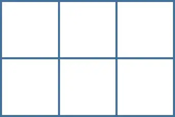

I was also thinking about the reason why we can do this. Then I thought about a world in which we have discrete lengths. The following image is constructed of such sticks. In the $x$-direction we have three sticks and in the $y$-direction we have 2 sticks. We can see that the enclosed area is consisting of $2 \times 3$ squares. Hence, if we define the area of one square as $\text{m} \times \text{m}$ the total area is equal to $6 \text{ m}^2$.
