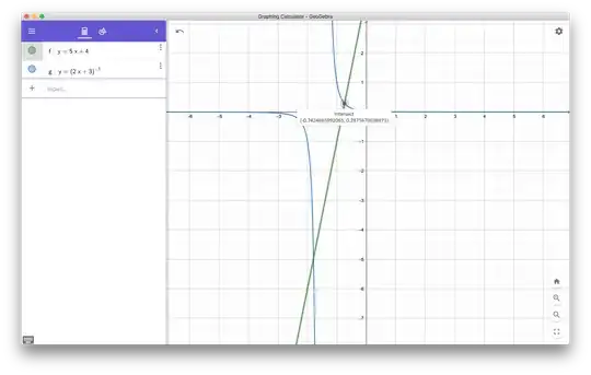

Since $10x^2+23x+12=(2x+3)(5x+4)$, my suggestion is to set $t=\log_{(2x+3)}(5x+4)$, so that $$ \log_{(5x+4)}(2x+3)=\frac{1}{t} $$ and the equation becomes $$ \frac{3}{t}-1-t=1 $$ so $t^2+2t-3=0$ and $t=1$ or $t=-3$.
The first case yields $5x+4=2x+3$, hence $x=-1/3$.
The second case yields $5x+4=(2x+3)^{-3}$. If we consider the two functions $f(x)=5x+4$ and $g(x)=(2x+3)^{-3}$, we can see that $$ f(-2)=-6,\quad g(-2)=-1,\qquad f(-1)=-1,\quad g(-1)=1,\qquad f(0)=4,\quad g(0)=1/27 $$ Hence the equation $f(x)=g(x)$ has two roots in the interval $(-2,0)$. For the one in the interval $(-2,-1)$, we have $f(x)=g(x)<0$, so this is not a solution.
For the one in the interval $(-1,0)$, we have $f(x)=g(x)>0$ and not $1$. So the solution is good for the problem.

  • Alright. But I was wondering is there an analytical way to find the exact root, as this was asked as a multiple choice question ?. and obviously my reference seems to be wrong about the real roots . – SOORAJ SOMAN Apr 27 '19 at 19:31
  • @ss1729 There is a formula for degree 4 equations. If you try it at WolframAlpha, you’ll get the explicit form. – egreg Apr 27 '19 at 20:37
