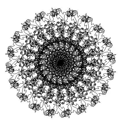

David's profile picture, a pretty complex shape with 20-fold rotational symmetry
"My icon is the graph of the exponential sum $$\sum_{n=1}^{10620}e^{2\pi if(n)}$$ for $$f(n)=\frac{n}{20}+\frac{n^2}{9}+\frac{n^3}{59}\ ,$$ where the "graph" of an exponential sum means the sequence of partial sums, plotted in the complex plane, with successive points joined by straight line segments."

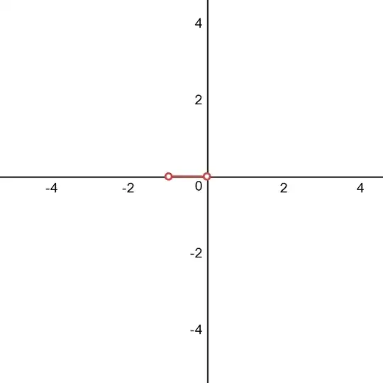

$n=2$: Coordinate system with red line from -1 to 0

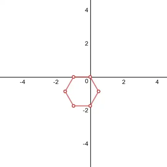

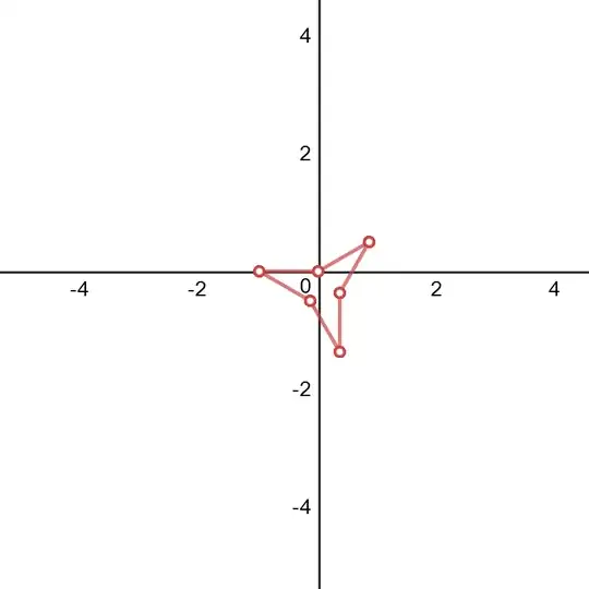

$n=3$: Coordinate system with regular hexagon whose upper horizontal line goes from -1 to 0

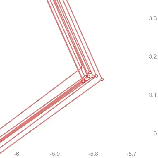

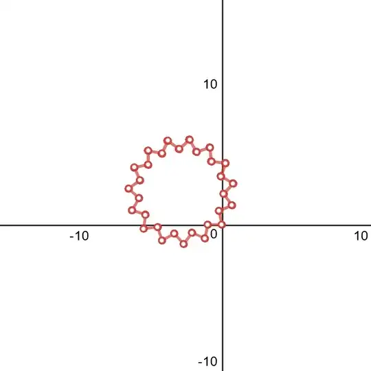

$n=5$: Zig-zag circle (15-pointed star with inner circle close to outer circle) I do not know how well you can see it, but the points are starting to move around a little. This is a picture of the $n=5$ graph when I zoomed in on one of the corners: Magnification of one corner of the above, showing that each line and corner is really many close lines and corners

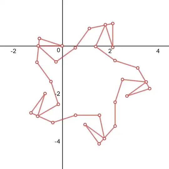

$n=6$: Pretty complex shape Needless to say, the wiggly effect has been amplified. For comparison, here's the $n=6$ graph of $p([1,2,...,31])$: Shape with 5-fold symmetry, looking somewhat like a paddle wheel with attached triangles

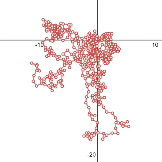

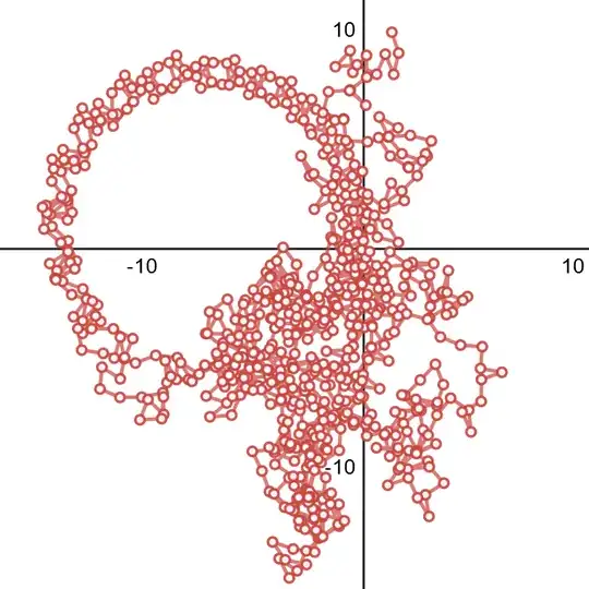

$n=7$: Another pretty complex shape Which is very far from well behaved. I think its 'supposed' to look something like the graph of $p([1,2,...,105])$: Another paddle wheel with attached triangles, now with 17 paddles Although even that has some drifty looking points.

At this point I'm fairly certain that the strange behavior (as demonstrated by the cases $n=5,6,7$) can be attributed to the accumulating numerical inaccuracies of Desmos. For example, Wolfram evaluates $$A=\sum_{r=1}^{700}\exp[2i\pi H_{7}(r)]$$ as $$A= -11.470821630307989891763598910658573978486117477630759175...\\ - 3.6768673678262517039383839969453158461799151084757854088... i$$ and provides a monstrous closed form. Whereas Desmos puts the sum at the wildly incorrect $$1.3535617164+9.88880050357i$$ I did the same sort of test with $B=\sum_{r=1}^{20}\exp[2i\pi H_5(r)]$ and Wolfram gave $$B=-6.3944653536668510841041628532095052345320229467766883302... \\+ 1.0127838162151622424794134150036094634983505690619992502... i$$ And Desmos gave $$-6.39446535424+1.01278381623i$$ Which is conclusive evidence that Desmos gets less accurate as $n$ and $x$ grow.
