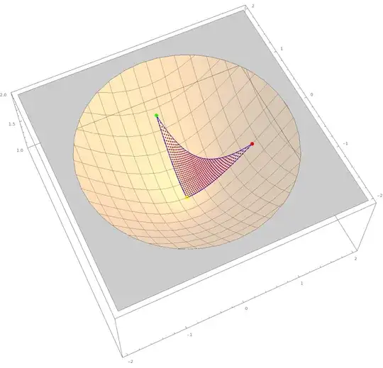

Let me attach the following image, for illustration. Let us look at the hyperboloid model $H^2$ in Minkowski space $M^3$ with bilinear form $\langle x, y \rangle = x_1 y_1 + x_2 y_2 - x_3 y_3$. Let $u_1 = (0,0,1)$, $u_2 = (\sinh 1,0,\cosh 1)$ and $u_3 = (0, \sinh 1, \cosh1)$. Let us then draw all the centroids $(u_1, t_1) \ast (u_2, t_2) \ast (u_3, t_3)$ for all $t_1 + t_2 + t_3 = 1$ in steps of $0.03$. We get this:
