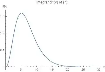

1.2 Simpler single integral
The expression derived in the previous paragraph is correct but not very useful because it contains the hypergeometric function. Here we derive the following simpler formula with an elementary integrand.
$$s_2 = \int_0^\infty \frac{v}{\sinh \left(\frac{v}{2}\right)} \left(\frac{v}{\sqrt{2-e^{-v}}}-2 \log \left(\frac{\sqrt{2-e^{-v}}+1}{e^{-\frac{v}{2}}+1}\right)\right)\,dv\tag{7}$$
This is a well converging integral, suited for numerical evaluation. The integrand is depicted here
The derivation starts with replacing both $H_n$ by (3) and (4).
This gives the integral
$$s = \int_0^1 \int_0^1 \frac{\log(1-x) \log(1-y)}{2(1-x y )^{\frac{3}{2}}}\,dx\,dy\tag{8}$$
Transforming $x\to 1-e^{-u}$, $y\to 1-e^{-v}$ leads to
$$s = \int_0^\infty \int_0^v (u v ) \frac{e^{\frac{u+v}{2}}}{(e^u + e^v -1 )^{\frac{3}{2}}}\,du\,dv\tag{8}$$
Here we have made use of the symmetry of the integrand to restrict the integration region to $u\le v$ (and applying a factor 2). Luckily the $u$-integral can be done with the result (7).
