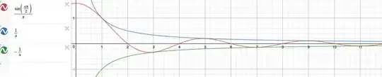

In the book by Bromwich, it is stated that in the above sequence, there are infinitely number of terms may equal limit; hence it is a convergent sequence.
I mean that there is no mention that the sequence is oscillatory.
Hence, want to know the graph of the series.
Better if could be given some sort of python\c\c++ code to generate the sequence.That would help for all such

As $$-1\le\sin{(x)}\le 1$$ We have that $$-\frac1n \le a_n \le \frac1n$$ Hence $$\lim_{n\to\infty} a_n=0$$ By squeeze theorem.
Peter Foreman
  • 20,095
$ 0 \leq |a_n| \leq \frac 1 n$ and hence $a_n \to 0$ by Sqeeze Theorem. Also $a_n$ equals its limit whenever $n$ is even.
Notice that whenever $n$ is even, $a_n=0$, hence if the sequence converges, it better converges to $0$.
Usually $n$ is reserved for interger, in particular in this context when we use it as a sequence index. Hence if you are really intested, just write a for loop to generate a few numbers.
But suppose even if you treat it as a real number and you ask the question, does
$$\lim_{x \to \infty}\frac{\sin (nx)}{x}$$
exists? and if so, what is the limit (it better be zero if it exists for the same reason).
We can again, use squeeze theorem since $-1\le \sin(\pi x/2)\le 1$.
For large $x$, $x$ is positive $$-\frac1x \le \frac{\sin(\pi x/2)}{x}\le \frac1x$$
Now, by squeeze theorem, the limit is $0$.
$$0=\lim_{x \to \infty }-\frac1x \le \lim_{x \to \infty}\frac{\sin(\pi x/2)}{x}\le \lim_{x \to \infty}\frac1x=0$$
