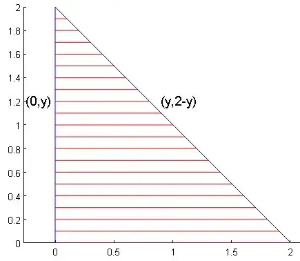

This is what we are going to do here with $f(x,y)=z=2-x-y$:
$$\int_{y=0}^{y=2}\left(\int_{x=0}^{x=2-y}(2-x-y)dx\right)dy$$
(please note the parentheses ; bounds of integration can be understood when looking at Fig. 1).
Fig. 1 : The way the domain of integration $D$ (in plane $xOy$) is swept, for a given $y$, from $x=0$ to $x=2-y$.
The integrand $(2-y)-x$ of the internal integral has an antiderivative (with respect to variable $x$) : $$(2-y)x-\frac{x^2}{2} \ \text{to be taken between} \ x=0 \ \text{and} \ x=2-y$$
giving for the final value of the internal integral
$$\frac{(2-y)^2}{2}$$
It now remains to compute : $\int_{y=0}^2 \frac{(2-y)^2}{2}dy$ ; its value is
$$\frac{-(2-y)^3}{6} \ \text{to be taken between} \ y=0 \ \text{and} \ y=2$$
which finally gives the result $\frac43$
