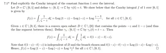

A detailed answer (7.1) can be found here https://wolfweb.unr.edu/homepage/alex/410/8s.pdf (see the snippet below)
