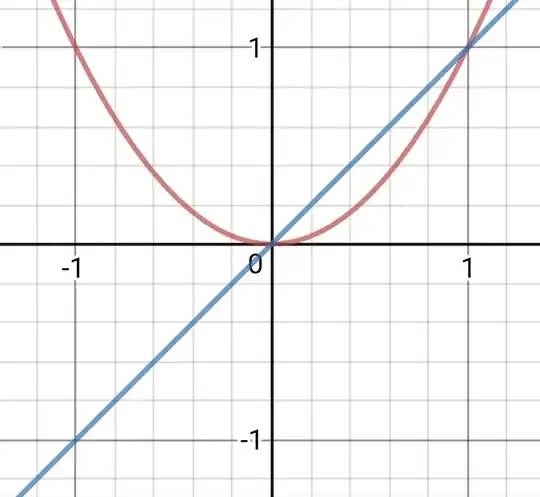

14
When two functions intersect, they don't have to have the same slopes. For example, $y=x^2, y=x$. y=x^2,x[1]
  • This is essentially the correct answer, but it might be worth pointing out that $$2x^2-x=1$$ describes the point(s) where the function on the left-hand side crosses the function on the right-hand side. – MSalters Mar 24 '19 at 23:05
