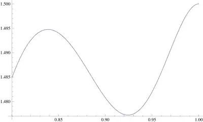

Optimal Value of $\boldsymbol{a}$
Without loss of generality, assume that $b=a$ and $c=a^{-2}$. Then we want to maximize $2f(a)+f\!\left(a^{-2}\right)$: $$ \begin{align} \frac{\mathrm{d}}{\mathrm{d}a}\left(2f(a)+f\!\left(a^{-2}\right)\right) &=\frac2a\left(af'(a)-a^{-2}f'\!\left(a^{-2}\right)\right)\\ &=0 \end{align} $$ is true when $a=1$. However, if $1\lt\beta\lt1.088$, there are two values of $a$ where the derivative vanishes. Looking at plots, it appears that the critical point at $a=1$ gives the maximum. In fact, if we look at the plot for $\beta=1$, the critical point at $a=1$ gives the maximum:
Greater values of $\beta$ give a smaller maximum for $a\lt1$.
If we accept that $a=b=c=1$ gives the maximum, we get $$ \left(\frac{a}{a^{11}+1}\right)^{1/\beta}+\left(\frac{b}{b^{11}+1}\right)^{1/\beta}+\left(\frac{c}{c^{11}+1}\right)^{1/\beta}\le3\left(\frac12\right)^{1/\beta} $$
