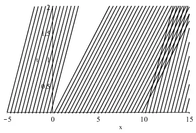

Here is a plot of the characteristic curves in the $x$-$t$ plane as deduced from the initial data:
characteristics
The flux $A \mapsto A^{3/2}$ is convex for positive cross sectional area $A$. Hence, the classical theory for weak entropy solutions of conservation laws applies. One can observe that
  • At $x=0$, characteristics separate. A rarefaction wave is created, which waveform $v(x/t)$ is given by the reciprocal of the function $A \mapsto \frac{3}{2}\sqrt{A}$, i.e., $v(x/t) = \frac{4}{9}(x/t)^2$.
  • At $x=10$, characteristics intersect. According to the Lax entropy condition, a shock wave is created, which speed $s$ satisfies the Rankine-Hugoniot condition $s = {(4^{3/2}-1^{3/2})}/{(4-1)}= \frac{7}{3}$.
Therefore, the entropy solution for small positive times reads $$ A(x,t) = \left\lbrace \begin{aligned} & 1 && x \leq \tfrac{3}{2} t \\ & \left(\tfrac{2x}{3t}\right)^2 && \tfrac{3}{2} t \leq x \leq 3 t\\ & 4 && 3 t \leq x \leq 10 + \tfrac{7}{3} t \\ & 1 && x \geq 10 + \tfrac{7}{3} t \end{aligned} \right. $$ which is valid at $t=1$. Indeed, the rarefaction wave does not catch the shock before the time $t^*$ such that $3 t^* = 10 + \tfrac{7}{3} t^*$, i.e., $t^* = 15$. The shock wave will reach $x=31$ at the time $21/\frac{7}{3} = 9$ at which the previous solution is still valid ($t < t^*$).
