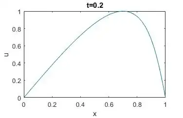

Indeed, the solution deduced from the method of characteristics satisfies $u = u_0(x - ut)$, to be solved for each point $(x,t)$ of interests. One approach is fixed-point iterations:
x = linspace(0,1,50);
u = x;
t = 0.2;
for i=1:length(x)
    fun = @(u) sin(pi*(x(i)-u*t));
    u0 = 0;
    err = abs(fun(u0)-u0);
    n = 0;
    while (err>1e-10)&&(n<100)
        u0 = fun(u0);
        n = n+1;
    end
    u(i) = u0;
end
plot(x,u);
xlabel('x');
ylabel('u');
title(strcat('t=',num2str(t)));
with the following output:
output
