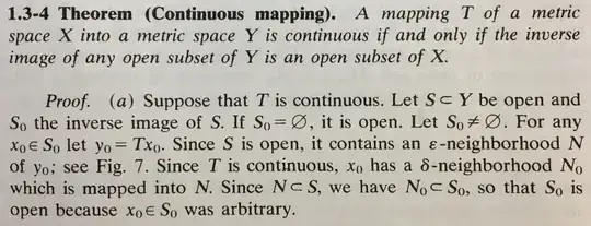

Here's the first part of the proof—the part I have a question about.

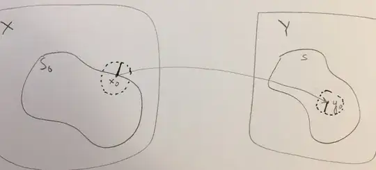

Simply put, I don't see anything here precluding $x_0$ from being on the boundary of $S_0$. And if that's the case then $N_0 \not\subset S_0$. Here's a picture of what's in my brain:
I'm sure that it's somehow implied $x_0$ can't be on the boundary but I'm not seeing it for some reason. Can someone please expand on the proof? Thank you.

The $x_0$ drawn by you in the question is NOT an interior point (but a limit point). If you recall the definition of an open set (from a metric space perspective), it needs all points of the set to be interior points.

Now you concern is: Why the point cannot be like what you drew (let's call it $x'$)?. Well, then for that $x'$ you drew, we cannot find a $\delta >0$ such that the above condition for continuity satisfies, and thus, $f$ is NOT continuous at the point $x'$ that you drew.
