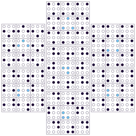

The claim made in the Concrete Nonsense blog is not actually true. The neighbourhoods of corner cells on the $\mathbb{RP}^2$ tic-tac-toe board are different from that of the centre – corner cells are diagonally adjacent to themselves – and this prevents using the translation arguments from the toroidal board. Indeed, I found $7$ cases, up to rotation and reflection, where the first three first-player moves don't lead to a win: However, the same peculiar properties of $\mathbb{RP}^2$ allow the first player to win in two moves. The first move is at the centre and the second move is at any unoccupied corner.

    I guess the visualization by adding boards is misleading. A winning pattern is one that can be made into a usual winning pattern (horizonal/vertical/diagonal line) by "translating" the board along glued sides. The X's and O's move along with the board. If you have only two X's on your board, there is no way you can translate it to make it three, even though the visualization would make it think so. But it seems that the blog post was indeed wrong. – Desura Mar 09 '19 at 15:18
  • @Desura You cannot translate the real projective plane because both directions are anti-parallel. You can translate a Klein bottle, a torus, because the copies line up in parallel strips. Shifting the RPP would introduce gaps. – Parcly Taxel Mar 09 '19 at 18:17
