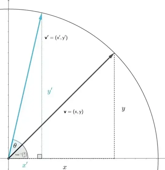

Rotation of an angle
where with some basic geometry, we can derive
$$x' = \|{\mathbf{v}}\|\cos\left(\theta + \tan^{-1}\left(\frac{y}{x}\right)\right) = x\cos\theta - y\sin\theta$$ $$y' = \|{\mathbf{v}}\|\sin\left(\theta + \tan^{-1}\left(\frac{y}{x}\right)\right) = x\sin\theta + y\cos\theta$$ This can be summarized in a matrix transformation $$\begin{bmatrix} x' \\ y' \end{bmatrix} = \begin{bmatrix} \cos\theta & -\sin\theta \\ \sin\theta & \cos\theta \end{bmatrix} \begin{bmatrix}x\\y\end{bmatrix}$$
giving the map: \begin{align*} x\mapsto x'=x\cos\theta - y\sin\theta \\ y\mapsto y'=x\sin\theta+y\cos\theta \end{align*}
