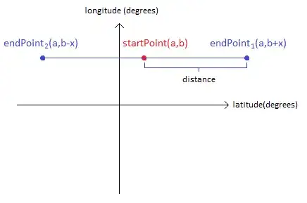

I need to calculate how many longitude degrees a certain distance from a point are, with the latitude held constant. Here's an illustration:
Here x represents the longitude degrees, the new point can be on either side of the starting point. I'm using the haversine formula, which calculates the distance between two points on a sphere given a radius, $r$, and a pair of coordinates expressed in latiude, $\phi$, and longitude, $\lambda$, degrees:

Which is obviously quite far from our desired $11°$, what am I doing wrong here?
