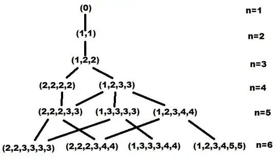

This image shows how to generate iteratively all solutions $(k_1, \dots, k_n)$ for all $n$, under the constraint $k_1 \le \dots \le k_n$.
The "sons" of every solution $(k_1, \dots , k_i, k_{i+1} \dots , k_n)$ are found by replacing $k_i$ with $(k_i+1, k_i+1)$ (under the constraint that $k_i < k_{i+1}$).
