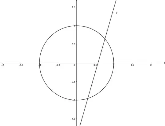

One more answer won't do any harm, hopefully. Here's another way to look at this "thing". Once you replaced $\sin x \cos x$ with $\frac{1}{2}\sin 2x$, your equation becomes $$\sqrt 3 \cos 2x - \frac{1}{2}\sin 2x = 1.$$ Recalling that cosine and sine are just abscissa and ordinate of points on the circumference of radius $1$, you can find the solutions by intersecting the line $$r: \sqrt 3 X - \frac{1}{2}Y = 1$$ with the circumference $$X^2 + Y^2 = 1.$$ This leads to the system of equations $$ \begin{cases} \sqrt 3 X - \frac{1}{2}Y = 1\\ X^2 + Y^2 = 1. \end{cases} $$ enter image description here
Replacing $Y = 2\sqrt 3 X - 2$ in the second equation yields the quadratic equation $$13X^2-8\sqrt 3 X +3 =0$$ with solutions $$ \cos 2x = X = \frac{4\sqrt 3 \pm 3}{13}.$$ Since solutions in terms of $2x$ are in first and fourth quadrant we can write the first set of solutions as $$2x = \arccos\frac{4\sqrt 3 + 3}{13} + 2k\pi, $$ that is $$\boxed{x = \frac{1}{2}\arccos\frac{4\sqrt 3 + 3}{13} + k\pi, \ \ k \in \Bbb Z}$$ and the second set of solutions as $$2x = -\arccos\frac{4\sqrt 3 - 3}{13} + 2k\pi,$$ that is $$\boxed{x = -\frac{1}{2}\arccos\frac{4\sqrt 3 - 3}{13} + k\pi,\ \ k \in \Bbb Z} $$

    Ah, very interesting to relate the equation back to the unit circle like this. It provides a way to verify the result from the R-formula, too. Appreciated, thank you. – lswift Feb 22 '19 at 21:05
  • @lswift you're welcome. Glad it helped. – dfnu Feb 22 '19 at 21:25
