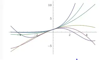

Function g(y)
The Wolfram Alpha plot of the numerators of $(8)$ shown above, illustrates the behavior of the function $g(y)$ for $a_2=\pm 0.9, \pm 0.6, \pm 0.3,\quad (y=-5,5).$
The solution of the issue equation in the case $|a_2| < 1$ is $$f\left(x,\vec a\right) = g(a_1(r-x)).\tag9$$
