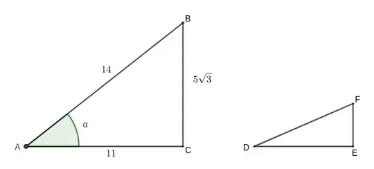

Hint: Draw a right triangle $\triangle ABC$ and label the lengths of two sides appropriately so that the base angle $\alpha=\arcsin\left(\frac{5\sqrt{3}}{14}\right)$ as in the diagram below. Then, by the Pythagorean Theorem, the remaining side must have length $11$.
Right Triangle Trig
Follow the example of the first triangle to appropriately label two sides of the second triangle $\triangle DEF$ so that the base angle at vertex $D$ is $\delta=\arctan\left(\frac{1}{4\sqrt{3}}\right)$. Use the Pythagorean Theorem to find the length of the third side.
Now the task is reduced to finding the angle $\alpha-\delta$. We know that both angles are positive acute angles and that $\alpha$ is the larger of the two, so we know that $\alpha-\delta$ is a positive acute angle and is one of the special angles which were mentioned in the problem.
Suggestion: Find $\sin(\alpha-\delta)$ using an identity which you studied and use the two triangles to find the values needed in the formula. You should find that $\sin(\alpha-\delta)$ is the sine of one of the special angles. Then you will have your answer.
