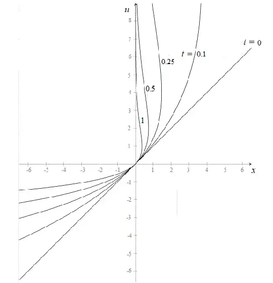

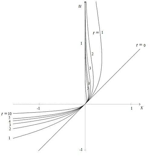

I agree with your result : $$x=u\,e^{-u\,t}$$ This is the solution on the form of implicit equation.
Of course, if one want the explicit form the Lambert W function is required
$u(x,t)=-\frac{1}{t} W\left(-t\,x \right)\quad$ But we don't need it to plot $u(x,t)$.
Drawing the curves $u(x)$ for various $t$ is very easy, without special function. Plot the inverse function $x(u)$ , which is explicit. Then symmetry/rotation make the figure on the usual orientation.
The solutions remain smooth from $t=0$ up to large $t$.
Nothing special appears at $t=4$ and latter.
If you draw the curves with the Lambert W function instead of the above very simple method you avoid possible numerical artefact (Of course, with a sufficient accuracy of the numerical computation of the Lambert W function the results must be the same for the two methods).
