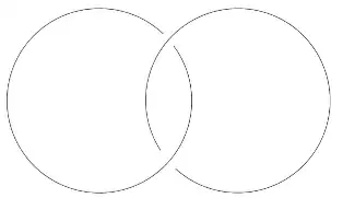

I am only going to give a definitive answer to question 2, and perhaps this is what Gerry was getting at. The answer is no, there are four regular planar graphs, with Eulerian Circuits which are not knots. My example, however, is a link, so it is not a resounding no. Consider the Hopf link.
The Hopf Link

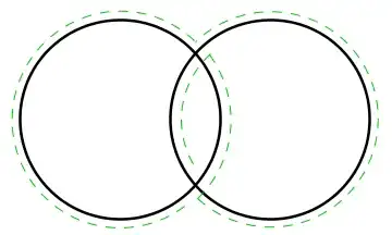

Here is an Eulerian circuit on the corresponding graph.
The Link with an Eulerian Circuit
So, I think we might be able to enforce a condition on always taking the "middle" path on our Eulerian circuits, and that might be sufficient, or at least eliminate examples like this one. But I do not know enough graph theory to say how you would nicely characterize taking the middle path.
