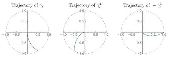

$$ \log z = \frac{1}{2}\log(z^2) = \frac{1}{3}\log (-z^3) - \frac{i\pi}{3} \qquad \text{for } z \in \gamma_{\epsilon}. $$
Here, the last step is a consequence of the branch cut of $\log(\cdot)$ together with the fact that the contours corresponding to $\gamma_{\varepsilon}$, $\gamma_{\varepsilon}^2$, and $-\gamma_{\varepsilon}^3$ are as follows:
contours of gamma powers
So, by applying further substitutions $-z^3 \mapsto z$ and $z^2 \mapsto z$ to $A_{\epsilon}$ and $B_{\epsilon}$, respectively, we get
\begin{align*} A_{\epsilon} &= \frac{1}{4} \int_{-\gamma_{\epsilon}^3} \frac{1}{z-1} \left( \frac{1}{3}\log z + \frac{i\pi}{6} \right)^2 \, \mathrm{d}z, \\ B_{\epsilon} &= \frac{1}{4} \int_{\gamma_{\epsilon}^2} \frac{1}{z-1} \left( \frac{1}{2}\log z + \frac{i\pi}{2} \right)^2 \, \mathrm{d}z. \end{align*}

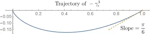

Step 3. For $A_{\varepsilon}$, the integrand has a simple pole at $z = 1$. Moreover, the terminal point of $-\gamma_{\epsilon}^3$ has an asymptotic formula of the form
$$ -(1-e^{i(\pi/3 - \epsilon)})^3 = 1 - 3e^{i\pi/6}\epsilon + \mathcal{O}(\epsilon^2) \qquad \text{as $\epsilon \to 0^+$.} $$
contour of negative gamma cube
So by replacing $-\gamma_{\epsilon}^3$ by the union of
  • $z = x$ for $0 \leq x \leq 1-3\epsilon$, which is the line segment from $0$ to $1-3\epsilon$;
  • $z = 1 - 3\epsilon e^{i\theta}$ for $0 \leq \theta \leq \frac{\pi}{6}$, which is the circular arc from $1-3\epsilon$ to $1-3\epsilon e^{i\pi/6}$;
  • the line segment from $1-3\epsilon e^{i\pi/6}$ to the terminal point of $-\gamma_{\epsilon}^3$;
it follows that
\begin{align*} &A_{\epsilon} \\ &= \frac{1}{4} \int_{0}^{1-3\epsilon} \frac{1}{x-1} \left( \frac{1}{3}\log x + \frac{i\pi}{6} \right)^2 \, \mathrm{d}x + \frac{i}{4} \int_{0}^{\frac{\pi}{6}} \left( \frac{1}{3}\log(1 - 3\epsilon e^{i\varphi}) + \frac{i\pi}{6} \right)^2 \, \mathrm{d}\varphi + \mathcal{O}(\epsilon) \\ &= \frac{i\pi}{36} \int_{0}^{1-3\epsilon} \frac{\log x}{x-1} \, \mathrm{d}x + \frac{i}{4} \cdot \frac{\pi}{6} \left( \frac{i\pi}{6} \right)^2 + \text{[some real number]} + \mathcal{O}(\epsilon). \end{align*}
