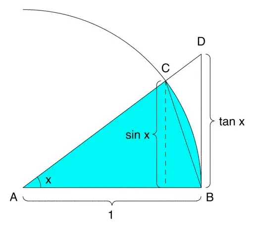

Most proofs uses the idea of comparing the area of one sector and two triangle (or two sectors and one triangle) as is shown below:
My question is, how does one prove that in the graph above, the sector $ABC$ is contained in the triangle $ABD$? Namely, given any point $P$ which is contained in the sector $ABC$, how do we prove that $P$ is always contained in the triangle $ABD$?
It seems to me that in most of Calculus books, this fact is assumed as intuitively clear but never strictly proved.

While a lot about this relies on fairly fuzzy intuition, that part at least is fairly clear. If $E$ is a point on the segment $BD$, then $AE =\sqrt{AB^2+BE^2}>AB$ by the Pythagorean theorem, and the intersection $F$ of line $AE$ with the circle lies inside the segment $AE$. Then $AF\subset AE$ (as sets of points), and every point inside the circular wedge in that direction from $A$ is inside the triangle. Take the union over all possible $E$, and the circular wedge is a subset of the triangle.
