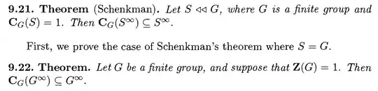

Your requirement that $Z(G)=1$ also gives that $C_G(L) \leq L$. This is a theorem of Schenkman's (see Isaacs' FGT book, p. $283$; $G^{\infty}$ is how Isaacs writes the nilpotent residual).
Since $L$ is abelian we also have $C_G(L) \geq L$, thus $C_G(L) =L$. Therefore $L$ is a maximal abelian normal subgroup of $G$. In particular, $L=G'=N$. The complement for $L$ in $G$ whose existence we had guaranteed before is $\cong G/L = G/N$, thus abelian by assumption and we are done.
