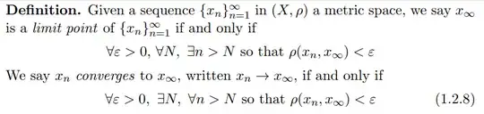

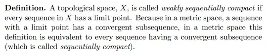

Some background (all of this is from Barry Simon's "Real Analysis - A comprehensive course in analysis - vol 1"):
Reading both definitions I can see the difference between weakly sequentially compact and sequentially compact, but I can't find an example of a topological space which is weakly sequentially compact but not sequentially compact or at least one space where we have a sequence with at least one limit point but which doesn't have any convergent subsequence.
