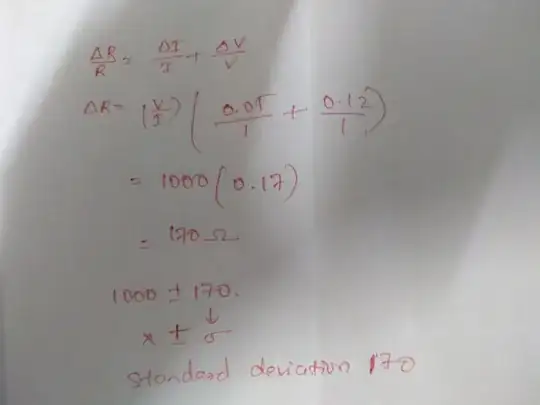

Since this question appeared in a prestigious national exam, I am confident a solution exists. Further this question was only worth 1 mark so I am expecting an elegant solution to exist.
Can we think of standard deviation as percent error? and simply add it?

  • What level is the exam? They might just want you to apply basic error propagation... – Thomas Feb 08 '19 at 13:47
  • It is meant for recently graduated students. GATE. I think you are right, it simply needs adding of the error I think. I can't believe I did not think of that. :( – Aditya P Feb 08 '19 at 13:50

    Mmm... For example here https://en.m.wikipedia.org/wiki/Propagation_of_uncertainty look at the two variable example . It is essentially what J.G. proposes as the delta method, but such formulas are usually presented in lab courses via intuitive approaches – Thomas Feb 09 '19 at 15:17
  • Thanks @Thomas, I understand due to to that wiki link you shared. They even have a section dedicated to the V/I problem - https://en.wikipedia.org/wiki/Propagation_of_uncertainty#Resistance_measurement – Aditya P Feb 16 '19 at 07:45
What you're expected to do here is use the delta method, affecting the approximation $\operatorname{Var}f(X_i)\approx\sum_i\left(\frac{\partial f}{\partial X_i}\right)^2\operatorname{Var}X_i$. In this case, $\sigma_Z^2\approx\frac{\sigma_X^2}{Y^2}+\frac{X^2\sigma_Y^2}{Y^4}$.

  • For the record you mean $E[X]^2$ when you say $X^2$ right? So that comes to $\sigma_Z = \sqrt{\frac{0.12^2}{10^-6} + \frac{1^2(0.05 \times 10^{-3})^2}{10^{-12}}} = 130$ – Aditya P Feb 08 '19 at 15:00
