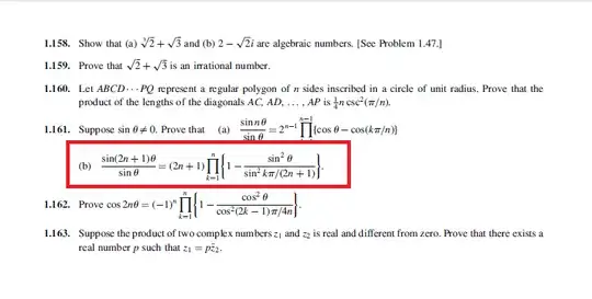

How to prove $$ \displaystyle \frac{\sin (2n+1)\theta}{\sin \theta} = (2n+1) \prod_{k=1}^{n}\left(1 - \frac{\sin^2 \theta}{\sin^2 \left( \frac{k\pi }{2n+1} \right ) } \right ) $$
So far, I manage to prove $ \displaystyle \frac{\sin (2n+1)\theta}{\sin \theta} = (2n+1) \prod_{k=1}^{2n}\left(1 - \frac{\sin \theta}{\sin \left( \frac{k\pi }{2n+1} \right ) } \right ) $ though I am not sure I am aright. enter image description here
