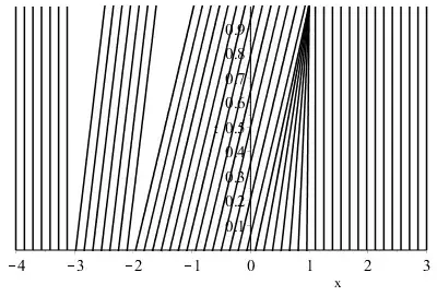

First of all, weak solutions are not unique. I guess that you rather want to find the entropy solution. Here is a plot of the characteristic curves in the $x$-$t$ plane, deduced from the method of characteristics:
char
In the vicinity of $x=-3$ and $x=-2$, characteristics separate. Hence, according to the Lax entropy condition, rarefaction waves are obtained. The entropy solution is smooth for small times $0<t < 1$ (see e.g. this post and related ones): $$ u(x,t) = \left\lbrace \begin{aligned} &0 && \text{if } x<-3 \\ &(x+3)/t && \text{if } {-3}<x<-3+t/2 \\ &1/2 && \text{if } {-3}+t/2<x<-2 + t/2 \\ &(x+2)/t && \text{if } {-2} + t/2 <x<-2 + t \\ &1 && \text{if } {-2}+t<x<t \\ &(1-x)/(1-t) && \text{if } t\leq x<1 \\ &0 && \text{if } x\geq 1 \end{aligned}\right. $$
At the time $t=1$, characteristic curves intersect (breaking time). To compute the solution for larger times, one must compute the shock wave starting at $(x,t)=(1,1)$ by using the Rankine-Hugoniot condition, which gives the shock speed $s = \frac{1}{2}(1 + 0) = 1/2$. Thus the solution for $1\leq t < t^*$ reads $$ u(x,t) = \left\lbrace \begin{aligned} &0 && \text{if } x<-3 \\ &(x+3)/t && \text{if } {-3}<x<-3+t/2 \\ &1/2 && \text{if } {-3}+t/2<x<-2 + t/2 \\ &(x+2)/t && \text{if } {-2} + t/2 <x<-2 + t \\ &1 && \text{if } {-2}+t<x<1+(t-1)/2 \\ &0 && \text{if } x\geq 1+(t-1)/2 \end{aligned}\right. $$
For larger times, one must consider the interaction between the shock wave and the rarefaction wave starting at $x=-2$, since the rarefaction moves faster than the shock. Both waves intersect at the time $t^*$ such that $-2 + t^* = 1+(t^*-1)/2$, i.e. $t^*=5$. The new shock has the speed $\dot x_s = \frac{1}{2}\left((x_s+2)/t + 0\right)$ deduced from the Rankine-Hugoniot condition. Since the interaction occurs at $x_s(t^*)=3$, we find $x_s(t) = \sqrt{5t}-2$. Thus, for $5\leq t < t^\dagger$, the solution reads $$ u(x,t) = \left\lbrace \begin{aligned} &0 && \text{if } x<-3 \\ &(x+3)/t && \text{if } {-3}<x<-3+t/2 \\ &1/2 && \text{if } {-3}+t/2<x<-2 + t/2 \\ &(x+2)/t && \text{if } {-2} + t/2 <x<\sqrt{5t}-2 \\ &0 && \text{if } x> \sqrt{5t}-2 \end{aligned}\right. $$
For larger times, one must consider the interaction between the shock wave and the constant state $u=1/2$, since it moves faster than the shock. Both waves intersect at the time $t^\dagger$ such that $-2 + t^\dagger/2 = \sqrt{5t^\dagger}-2$, i.e. $t^\dagger=20$. The new shock has the speed $s = \frac{1}{2} (1/2 + 0)$ deduced from the Rankine-Hugoniot condition, and we find $x_s(t) = 3+t/4$. Thus, for $20\leq t < t^\circ$, the solution reads $$ u(x,t) = \left\lbrace \begin{aligned} &0 && \text{if } x<-3 \\ &(x+3)/t && \text{if } {-3}<x<-3+t/2 \\ &1/2 && \text{if } {-3}+t/2<x<3+t/4 \\ &0 && \text{if } x> 3+t/4 \end{aligned}\right. $$ For larger times, one must consider the interaction between the shock wave and the rarefaction starting at $x=-3$, since it moves faster than the shock. Both waves intersect at the time $t^\dagger$ such that $-3+t^\circ/2 = 3+t^\circ/4$, i.e. $t^\circ=24$. The new shock has the speed $\dot x_s = \frac{1}{2} ((x_s+3)/t + 0)$ deduced from the Rankine-Hugoniot condition. Since the interaction occurs at $x_s(t^\circ)=9$, we find $x_s(t) = \sqrt{6t}-3$. Thus, for $24\leq t$, the solution reads $$ u(x,t) = \left\lbrace \begin{aligned} &0 && \text{if } x<-3 \\ &(x+3)/t && \text{if } {-3}<x<\sqrt{6t}-3\\ &0 && \text{if } x> \sqrt{6t}-3 \end{aligned}\right. $$ The right edge of the wave has amplitude $\sqrt{6/t}$. Thus, its amplitude and propagation speed decrease with time.
EditPiAf

  • What program did you use to plot the characteristics? – ViktorStein Aug 19 '19 at 11:05
  • @ViktorGlombik It is a homemade Maple script. – EditPiAf Aug 19 '19 at 12:09
  • Hi, sorry for commenting here, but could you explain why you get $(x+3)/t$ for $-3<x<-3+t/2$, instead of just $x/t$? Same with the $(x+2)/t$ part. – Applesauce44 Dec 13 '21 at 20:48
  • @Applesauce44 The rarefaction wave solution $x/t$ solves Riemann problems for initial discontinuities located at $x=0$. For an initial discontinuity at $x=x_0$ we get the solution $(x-x_0)/t$. Now set $x_0$ to -2 or -3. – EditPiAf Dec 19 '21 at 21:19
