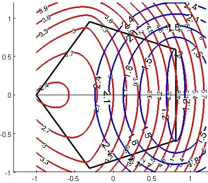

Consider figure $1$ that depicts some contour lines of functions $n$ (in blue) and $d$ (in red) :
Fig. 1. : To each point $X$ in the plane is attached two curves, a red one and a blue one giving the locus of points having resp. the same numerator $n(X)$ and the same denominator $d(X)$. One shouldn't be surprized that the blue curves are confocal ellipses (with foci $A$ and $B$).

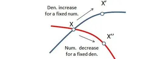

A first result is that a point $X$ can be a minimum of function $q$ (or at least a relative minimum), if the blue and the red contour lines passing through $X$ are tangent ; otherwise, if these curves are transverse in $X$ (transverse = non tangent), there are two directions (see Fig. 2) one can take that are more advantageous.
Fig. 2 : A minimum of function $q$ cannot occur in a point $X$ with transverse intersection of the blue and red contour lines passing through this point : indeed, moving $X$ in one of the given directions decreases the value of $q$.

What are the remaining candidate points for the minimum of $q(.)$ ? A concrete example is provided by the tangency of blue curve indexed by $1.2$ (the most elongated ellipse) and the red curve indexed by $5.1$ [just at the right of vertical line segment $AB$]. A detailed look show that all solution points $X$ are in this area and constitute a continuum of points ; a more detailed analysis is needed to prove that this "continuum" is the small circular arc $AB$ of the unit circle. I haven't done it.

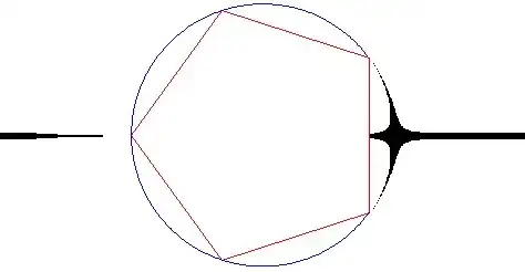

Let us use formulation (3) to obtain a graphical representation of the points under consideration : see figure $3$ below (which does not constitute - of course - a mathematical proof) where the circular arc AB appears as the solution.
Fig. 3. In black, all points $X$ having almost proportional gradients. See Appendix 1.
Appendix 1 : The Matlab program that has generated Fig. 3. reminder : this program generates all points for which this expression is close to $0$.
