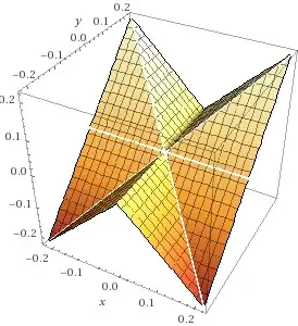

From the graph of the function $f$, we can see that even the directional derivative is defined for all direction at the origin, the tangent surface at the origin is not a plane.
f
