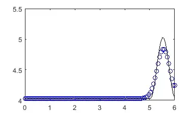

My question is how do we implement the solution numerically in matlab? Numerically, we can discretize the PDE using the following scheme Lax
$$ \frac{ u_j^{n+1} - \frac{1}{2}( u_{j+1}^n + u_{j-1}^n) }{\Delta t} + \frac{ u_{j+1}^n - u_{j-1}^n }{2 \Delta x} =0 $$
say for $x \in [0,6]$ and $t \in [0,4]$

For $v_t+v_x=1$, the solution to the Cauchy problem $v(x,0)=F(x)$ obtained with the method of characteristics is $$ v(x,t) = F(x-t) +t . $$ The Lax-Friedrichs method reads $$ \frac{v_i^{n+1}-\frac{1}{2}(v_{i-1}^{n}+v_{i+1}^{n})}{\Delta t} + \frac{v_{i+1}^{n}-v_{i-1}^{n}}{2 \Delta x} = 1 $$ where $v_i^n \simeq v(i\Delta x, n\Delta t)$. This method is stable for small time steps according to the Courant-Friedrichs-Lewy condition $\Delta t < \Delta x$. Now, we only need to translate the previous algorithm into MATLAB syntax.
%% Initialisation
F = @(x) sin(pi*(x-1)).^2 .* (1<x).*(x<2);
n = 100;
x = linspace(0,6,n);
dx = 6/(n-1);
t = 0;
dt = 0.95*dx;
v = F(x);
figure;
plot(x,v,'k-');
%% Scheme iterations
while t<4
    v(2:n-1) = 0.5*((1+dt/dx)*v(1:n-2) + (1-dt/dx)*v(3:n)) + dt;
    v(1) = v(2);
    v(n) = v(n-1);
    t = t + dt;
end
%% Output
plot(x,v,'bo');
hold on
plot(x,F(x-t)+t,'k-');
Outut

  • It would be more idiomatic to replace the inner loop with a vectorized operation vtemp(2:n-1) = 0.5*(v(1:n-2)+v(3:n)) - 0.5*dt/dx*(v(3:n)-v(1:n-2)) + dt; – Lutz Lehmann Jan 13 '19 at 12:56
  • @LutzL Thanks for the suggestion. We can even factorize to avoid multiple vector extractions and remove the temporary data vector vtemp. – EditPiAf Jan 13 '19 at 16:31
