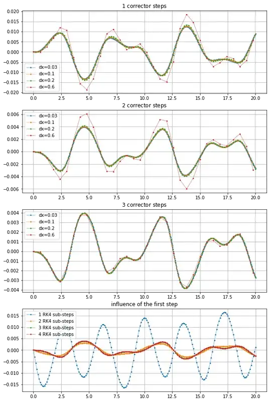

The following graphs depict the (leading) error coefficient, that is, the difference of the numerical and exact solution divided by $h^4$.
That the graphs for the different step sizes are of the same scale and visually approaching some limit confirms that the method is of order $4$. Note that the first graph for 1 corrector step has a larger scale for the values than the next two, as predicted. One can see that there is some slight improvement from the second to the third corrector step in the larger step sizes. In this example it is not large enough to justify the third corrector step, but for other problems the difference might be more significant.
The last graph shows the influence of the error of the first step. Having a simple 5th order error is not enough, to get to the optimal error behavior of the whole method, the first-step error coefficient needs to be reduced (by a factor 16 or 81) by using 2 or 3 RK4 sub-steps. Using 2 steps and Richardson extrapolation could also be a useful variant
