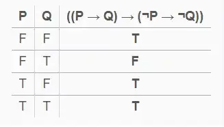

    For your first question, find a pair of values for $\phi$ and $\psi$ such that the formula above the line is true but the formula below is false. For your second question, see Mauro's answer. –  Jan 06 '19 at 19:37
The first question is:
To show this would I just make the truth tables for the statement above the line and below the line and show that they are not equivalent?
One would check that the premise implies the conclusion noting any line in the truth table where that is not true. From that line one can build a counter-example.

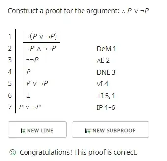

For the second question, the OP wants to show $⊢p∨¬p$. One is permitted to use this portion of the De Morgan rules: $¬(p∨¬p)→p∧¬p $.
Proceeding the way the OP starts to show this we could derive a proof using a Fitch-style proof checker as follows:
