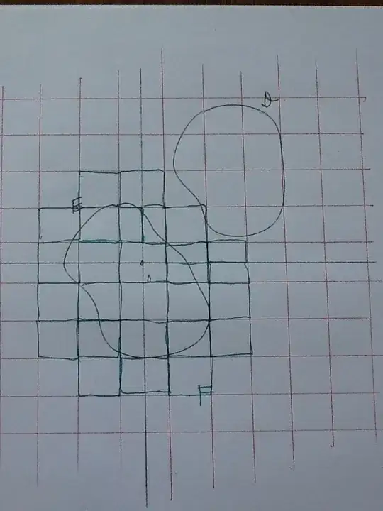

I've found a suggested proof online that says "Note by construction, $\partial F\subset D$. I've attached a picture which shows my grid of squares, set $D$ and set $E$ containing 0. I've outlined in green all of the squares that meet $E$ or that border on a square meeting $E$ (I think). The union of these closed squares in the grid is called F.
My first question is, how is $\partial F$, the border of $F$, contained in $D$?

As for the question why $\partial F\subset D$, consider the following: if $z\in \partial F$, then at least one of the (closed) grid squares containing $z$ is not contained in $F$. Hence, this square is at a positive distance from $E$. Since this distance does not exceed $\delta\sqrt{2}$, the claim $z\in D$ follows from the properties of $E$.

  • OK, E is a connected component of $C^*\backslash D$ which contains 0. So it can't intersect the connected component that contains $\infty$. I see F contains E, but the statement $\partial F$ is far from the other components and must be contained in $D$ is what I don't see. Why is this so? And is it possible to draw an image to illustrate this point? – David Feb 17 '13 at 19:20
