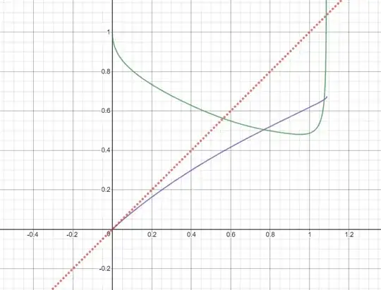

Here I will attempt to prove the monotonicity of $F_\infty$. First, let us introduce some definitions. $$F:=F_{\infty},\quad G:=\sqrt{\frac{x^2}{x-\sqrt{\frac{x^3}{x+\sqrt{\frac{x^4}{x- \sqrt{ \frac{x^5}{x+\cdots}}}}}}}},\quad H:=\sqrt{\frac{x^3}{x+\sqrt{\frac{x^4}{x-\sqrt{\frac{x^5}{x+ \sqrt{ \frac{x^6}{x+\cdots}}}}}}}}$$ Since $F=\sqrt{\dfrac x{x+G}}$, for (increasing) monotonicity to occur, $$F'=\frac1{2F}\cdot\frac{1(x+G)-x(1+G')}{(x+G)^2}>0\impliedby G-xG'>0$$ as $(x+G)^2$ and $F$ are clearly non-negative.
Now this is implied by $$G'=\frac1{2G}\cdot\left(1+\frac{H'x^2-H}{(x-H)^2}\right)<\frac Gx$$ and since $G=\sqrt{\dfrac{x^2}{x-H}}$ (note that $H<x$), we get \begin{align}2G^2>x+x\frac{H'x^2-H}{(x-H)^2}&\impliedby\frac{2x}{x-H}>1+\frac{H'x^2-H}{(x-H)^2}\\&\impliedby 2x^2-2Hx>x^2-2Hx+H^2+H'x^2-H^2\\&\impliedby x^2>H'x^2\impliedby H'<1\end{align} Unfortunately the fact that $H<x$ only cannot imply this; however, the following plot verifies the nice inequality. The dotted red line is the line $y=x$; the purple curve is $H$ (up to $x^{11}$) and the green curve is $H'$. Of course, the latter two are only close approximations to the real distribution of $H$.
