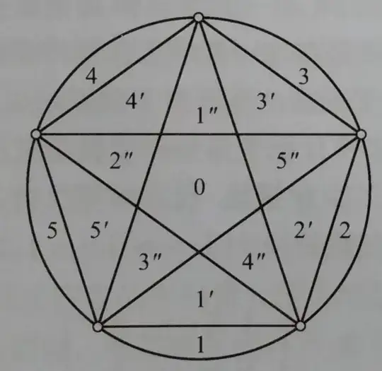

Assuming there are n points on a circle, then there are $C_n^2$ chords. If any three chords don't intersect in circle. How to show the circle will be divided into $1+ C_n^2 + C_n^4$ domains?
Picture below is a example of 5 points on circle.

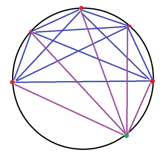

Induction step: Say the formula is correct for $n = k$. Now take the figure for $k$ points, and add another point. How many new regions did we make? Well, for each of the $k$ new chords we draw, we can find out how many regions it cut into two new regions, and add them together.
Below is a picture for $k = 5$, with old points in red, old chords in blue, the new point in green (the lowest one), and the new chords in purple.
How many regions does one of the new chords divide? If you look at the drawing you can convince yourself that it's the number of old chords it intersects (not counting the chords that share an end point) plus 1. And the new chord intersects an old chord if and only if the end points of the old chord are on opposite sides of the new chord. So the number of old chords that a new chord intersects is simply the number of old points to its left multiplied by the number of points to its right (again, not including its end point).
Let's label the new chords $1$ through $k$, from left to right. As an example, chord number $1$ (the leftmost new chord) has no old points on its left and four on its right, so it intersects $0\cdot 4 = 0$ chords and therefore makes $0 + 1$ new regions. Chord number $3$, on the other hand (the middle new chord), has two old points on its left and two new points on its right, and therefore intersects $2\cdot 2 = 4$ chords, meaning it makes $4+1 = 5$ new regions. In general, for chord number $i$, there are $i-1$ old points on its left and $k-i$ old points on its right, so it intersects $(i-1)(k-i)$ chords and thus makes $(i-1)(k-i) + 1$ new regions.
Thus the number of regions for $n = k+1$ is $$ 1 + \binom k2 + \binom k4 + \sum_{i = 1}^k \big[ (i-1)(k-i) + 1 \big]\\ = 1 + \binom k2 + \binom k4 + \sum_{i = 1}^k(ik - i^2 - k + i + 1)\\ = 1 + \binom k2 + \binom k4 + k\binom {k + 1}2 - \frac{k(k+1)(2k+1)}{6} - k^2 + \binom {k+1}2 + k $$ where I've used the well-known formulas for sums of consecutive integers and sums of consecutive squares. In here we have $1$ and we have a $\binom{k+1}2$, so for this to be equal to what we want, namely $1 + \binom{k+1}2 + \binom{k+1}4$, the only thing left is to prove that the remaining terms match up. In other words that $$ \binom k2 + \binom k4 + k\binom {k+1}2 - \frac{k(k+1)(2k+1)}6 - k^2 + k= \binom{k+1}4 $$ Here one can just insert, calculate and check. Or one can simplify a bit first, using $\binom{k+1}4 = \binom k3 + \binom k4$, and then insert and calculate: $$ \binom {k}2 + k\binom {k+1}2 - \frac{k(k+1)(2k+1)}6 - k^2 + k= \binom k3\\ \frac{k^2 - k}2 + \frac{k^3+k^2}{2} - \frac{2k^3+3k^2 + k}{6} - k^2 + k= \frac{k^3 - 3k^2 + 2k}{6} $$ Confirming that this is indeed true is not very difficult.
