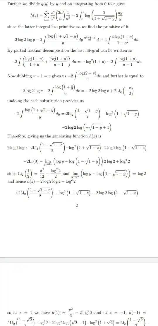

Since $$\sum_{n=0}^{\infty}\frac{H_n}{n+1} x^{n+1} =\frac{\log^2(1-x)}{2}$$ with $x \mapsto \sin^2 x$. and hence on integrating we obtain $$\int_0^{\frac{\pi}{2}}\log^2(\cos^2 x) dx = \pi\sum_{n=1}^{\infty}\frac{H_{n-1}}{n4^n}{2n\choose n}=\pi\sum_{n=1}^{\infty}\frac{H_n}{n4^n}{2n\choose n} -\pi\sum_{n=1}^{\infty}\frac{1}{n^24^n}{2n\choose n}$$ since the latter series $\mathcal{LS}$ is known whose value is $\displaystyle \zeta(2)-2\log^2(2)$ which is easily do able by computing the following integral $$2\int_0^1 \log\left(\frac{2}{\sqrt {1-x}+1}\right)\frac{dx}{x}=\zeta(2)-2\log^2(2)$$. Below I have derived the generating function for $\displaystyle \sum_{n\geq 1}{2n\choose n}\frac{y^n}{n^24^n}$ enter image description here and to evaluate the former series $\mathcal{FS}$, we use the elementary integral $\displaystyle \int_0^1 x^{n-1} \log(1-x)dx =-\frac{H_n}{n}$ and generating function of central binomial coefficients $\displaystyle \sum_{n\geq 1} \frac{x^n}{4^n}{2n\choose n}=\frac{1}{\sqrt{1-x}}-1$ which we too use to calculate the latter series. Now, we just need to divide both sides by x, multiply $\log(1-x)$ and integrating from 0 to 1 gives $$-\mathcal{FS} =\int_0^1\frac{\log(1-x)}{x\sqrt{1-x}}dx-\int_0^1\frac{\log(1-x)}{x}dx=4\int_0^{\frac{\pi}{2}}\frac{\log(x)}{1-x^2} dx+\zeta(2)$$ since $$\int_0^1\frac{\log(1-x)}{x\sqrt {1-x}} dx=2\int_0^1\frac{\log\left(\sqrt{1-x}\right)}{x\sqrt{1-x}}dx\stackrel{\rm \sqrt{1-x}\mapsto x}{=}4\int_0^1\frac{\log(x)}{1-x^2}dx=-\frac{\pi^2}{2}$$ so $$\displaystyle -\pi\mathcal{FS}=\frac{\pi^3}{3},\; \pi\mathcal{LS} =\frac{\pi^3}{6}-2\pi\log^2(2)$$ and hence $-\pi\mathcal{FS}-\pi\mathcal{LS} =\frac{\pi^3}{6}+2\pi\log^2(2)$.
