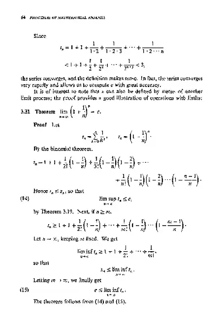

I want to put this as an answer rather than a comment so that people can find it easily:
https://en.wikipedia.org/wiki/Characterizations_of_the_exponential_function#Equivalence_of_characterizations_1_and_2
^ Wikipedia has the cleanest approach I can find. i.e. It doesn't pull anything out of the blue, and it doesn't sit on top of other advanced results.
I'm not going to replicate the working; I am confident it will not change for the worse.
EDIT: I just noticed it cites its source as Rudin, theorem 3.31, p. 63–5, so it is the same as the picture posted in another answer!

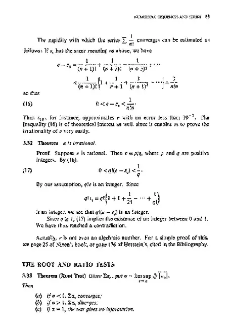

A great elementary proof is on Rudin's Principles of Mathematical Analysis page 64 Theorem 3.31.
PS: Sorry I don't know how to stretch it, maybe you can download the pic and enlarge.
