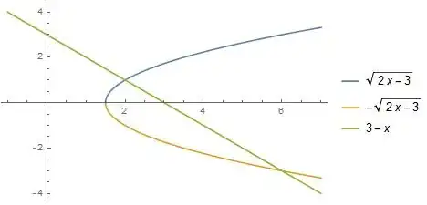

which has two solutions. However this equation can also be obtained by squaring
$$-\sqrt{2x-3} = 3-x$$
The second solution is the solution to this second equation. This is easy to see with a plot:
