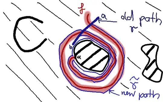

This implies that $\operatorname{img}(f)$ is locally connected, so we can cover it with a corresponding collection of open disks. We can find a Lebesgue number $r > 0$ such that any $r$-ball around a point in $\operatorname{img}(f)$ lies in the union of the covering.
Now their union yields some kind of inflation of the path $f$, so that it is open.
The idea is to jiggle $f$ around in this inflation such that it continues $γ$ to $a$ and $b$. But I fear I can't finish this argumentation, for one has to consider the boundary as well and I'm getting tired. So instead I made this beautiful picture in gimp using my trackpoint:
beautiful
k.stm

    It seems to me that this is essentially the same argument as ofer's. And like in ofer's argument, the end is not so obvious. – Julien Feb 16 '13 at 15:48
  • @julien Yes, and I was pretty angry with him that he posted it before me. : - ( – k.stm Feb 16 '13 at 15:57
  • These things happen all the time over here... – Julien Feb 16 '13 at 15:58
