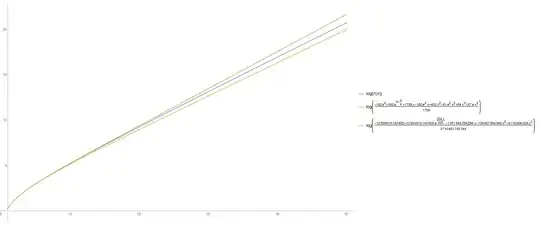

Further: Improving (slightly) on the lower bound on $\log f$ by the low-order terms, and improving on the constant in the main asymptotics of the upper bound of $\log f$.
I will show $$ h(x) \leq f(x) \leq g(x) \tag{7} $$ where $$ \begin{align} \log h(x) &= \frac{1}{e}x + 4 - \log\frac{32}{3} + o(1) \tag{8}\\ \log g(x) &= \frac{256}{625}x + O(1) \tag{9} \end{align} $$ (note that $\frac{256}{625} \approx \frac{1}{e}+0.04$). Moreover, this can be improved by the same method, pushing to more accurate estimates, but this will get uglier. (One can also push the Taylor expansion above further, based on (12) and (13). I stopped at $o(1)$).
The observation is that for the upper and lower bound, we bounded uniformly the coefficients by $$ \forall n \geq 1\, \qquad \frac{1}{n^n} \leq \frac{1}{\left(1+\frac{1}{n}\right)^{n}} \cdot \frac{1}{n^n} \leq \frac{1}{e}\cdot \frac{1}{n^n} $$ to obtain the two corresponding differential equations. We can do better by handling the first few terms more tightly. Namely, we have $$ \left(1+\frac{1}{n}\right)^n = \begin{cases} \frac{1}{2} & n=1\\ \frac{4}{9} & n=2\\ \frac{27}{64} & n=3\\ \frac{256}{625} & n=4 \end{cases} $$ (and, of course, $\left(1+\frac{1}{n}\right)^n$ is decreasing to $1/e$). Thus, we can leverage this and solve instead the following two differential equations for $h$ and $g$: \begin{align} h'(x) &= 1 + \left(\frac{1}{2} - \frac{1}{e}\right) x + \left(\frac{4}{9} - \frac{1}{e}\right) \frac{x^2}{4} + \left( \frac{27}{64} - \frac{1}{e}\right) \frac{x^3}{27} + \frac{1}{e}h(x)\tag{10}\\ g'(x) &= 1 + \left(\frac{1}{2} - \frac{256}{625}\right) x + \left(\frac{4}{9} - \frac{256}{625}\right) \frac{x^2}{4} + \left( \frac{27}{64} - \frac{256}{625}\right) \frac{x^3}{27} + \frac{256}{625}g(x)\tag{11} \end{align} subject to $h(0)=g(0)=0$. Solving those gives a nasty expression, \begin{align} h(x) &= \frac{3}{32} e^{4 + \frac{1}{e}x} + \left(\frac{1}{27} - \frac{e}{64}\right) x^3 + \left(\frac{1}{4} - \frac{3 e^2}{64}\right) x^2 + \left(1 - \frac{3e^3}{32}\right) x -\frac{3e^4}{32} \tag{12} \\ g(x) &= \frac{457763671875}{137438953472}e^{\frac{256}{625}x} - \frac{491}{442368}x^3 - \frac{123299}{4194304}x^2 - \frac{195550963}{536870912}x -\frac{457763671875}{137438953472} \tag{13} \\ \end{align} leading to the claimed (8) and (9).
Below, a plot illustrating those approximations:

  • Note: I believe the lower bound to be tight, i.e., $\log f(x) = x/e +o(x)$. One can get closer to the constant $1/e$ by the above approach, by treating the first few terms of the series separately to get a better differential equation lower bound (since higher terms allow a better bound on $(1+1/n)^n$). – Clement C. Dec 25 '18 at 19:24

  • Should be fixed (except for something inconsequential in the plot, which changes nothing). Now, back to my second flight. – Clement C. Dec 26 '18 at 00:55
  • Updated to give slightly tighter lower bound, and better upper bound, and explain a general method to improve them incrementally. – Clement C. Dec 26 '18 at 19:49
