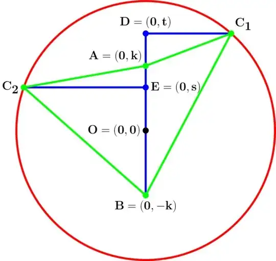

In the diagram at the end of this query, $\;\mathscr{C}, r, k,\;$ point $A$ and point $B$ are as described in the Curiousity section, at the start of this query.
Randomly choose $t$ in $\;(k, r)\;$ and assign point $D$ the cartesian coordinates $(0,t).$
Let point $C_1$ represent the right-hand-side intersection of $\;\mathscr{C}\;$ with the line $\;y=t.$
Similarly, randomly choose $s$ in $\;(0,k),\;$ and assign point $E$ the cartesian coordinate $\;(0,s).$
Similarly, let point $C_2$ represent the left-hand-side intersection of $\;\mathscr{C}\;$ with the line $\;y=s.$
$\left|\;\overline{DC_1}\;\right|^2 \;= \;r^2 - t^2.$
$\left|\;\overline{AC_1}\;\right|^2 \;= \;(t-k)^2 + \left|\;\overline{DC_1}\;\right|^2.$
$\left|\;\overline{BC_1}\;\right|^2 \;= \;(t+k)^2 + \left|\;\overline{DC_1}\;\right|^2.$
$\left|\;\overline{AC_1}\;\right|^2 + \left|\;\overline{BC_1}\;\right|^2 \;= \;2(t^2 + k^2) \;+ \;2(r^2 - t^2) \;= \;2(r^2 + k^2).$
$\left|\;\overline{EC_2}\;\right|^2 \;= \;r^2 - s^2.$
$\left|\;\overline{AC_2}\;\right|^2 \;= \;(k-s)^2 + \left|\;\overline{EC_2}\;\right|^2.$
$\left|\;\overline{BC_2}\;\right|^2 \;= \;(k+s)^2 + \left|\;\overline{EC_2}\;\right|^2.$
$\left|\;\overline{AC_2}\;\right|^2 + \left|\;\overline{BC_2}\;\right|^2 \;= \;2(k^2 + s^2) \;+ \;2(r^2 - s^2) \;= \;2(r^2 + k^2).$

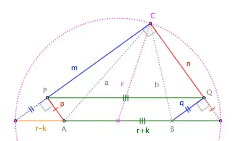

Here's an alternative (but still very "algebraic") derivation that leverages Thales' theorem (the angle inscribed in a semicircle is right):
$$\begin{align} a^2+b^2 &= \left(m^2+p^2\right)+\left(n^2+q^2\right) \\ &=\left(m^2+n^2\right)+\left(p^2+q^2\right) \\ &=\left(r+k\right)^2+\left(r-k\right)^2 \\ &=2\left(r^2+k^2\right) \end{align}$$
This result, which relates the length of a median to other segments in $\triangle ABC$, is Apollonius's Theorem. It's a special case of Stewart's Theorem for the length of an arbitrary cevian.
