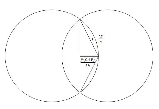

The volume of the intersection is given by the following integral based on a general equation for the area of the intersection of two same-sized circles in this scenario, dependent on the value of y:
$$V_i =\int_0^{h_i}\big(2\cos^{-1}(\frac{y(a+b)}{2r(h-y)})\cdot(r-\frac{ry}{h})^2 - \sqrt{(r-\frac{ry}{h})^2-(\frac{y(a+b)}{2h})^2}\cdot(\frac{y(a+b)}{h})\bigr) dy$$
Example: $a=3, b=4, h=5\ \text{and}\ r=3$
$h_i = \frac{30}{13}$ which is the height of the conic wedge
$$V_i =\int_0^{30/13} 2\cos^{-1}(\frac{7y}{6(5-y)})\cdot(3-\frac{3y}{5})^2 - \sqrt{(3-\frac{3y}{5})^2-(\frac{7y}{10})^2}\cdot(\frac{7y}{5}) dy$$
An integral solver couldn't come up with an anti-derivative but used an approximation method and came up with $25.25762\ \#^3$
