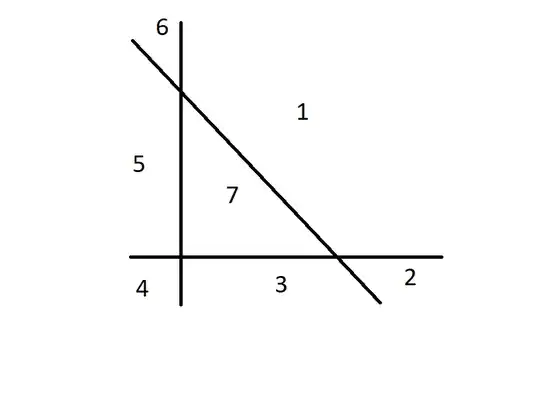

  • When you say it is false, do you think that the maximum number of connected components is higher? Lower? The number of connected components can indeed be equal to 14. – mathcounterexamples.net Dec 05 '18 at 14:22
  • @mathcounterexamples.net but, according to circle cutting problem, the number of connected components should be about 11. Could you show how it is $14$. So circle cutting is not valid in higher dimensions, I suppose? – vidyarthi Dec 05 '18 at 14:47
Take following planes: $$\begin{cases} H_1 &\equiv z= 0 \\ H_2 &\equiv y= 0\\ H_3 &\equiv x=0 \\ H_4 &\equiv x+y = k\ , k\neq0 \end{cases}$$
You'll find that the number of connected components of $\mathbb{R}^3 \setminus (H_1\cup H_2\cup H_3\cup H_4)$ is equal to $14$ (look at the number of connected components of $H_1 \setminus (H_2\cup H_3\cup H_4)$ first which is equal to $7$).
