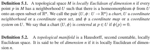

In section 5.3, Tu says a "manifold" has dimension $n$ if all of its connected components have dimension n in Definition 5.9 below:
Back in Section 5.1, Tu says in Definition 5.2 that a topological manifold $M$ has dimension $n$ if $M$ is locally Euclidean of dimension $n$.
  1. In Definition 5.9, does the "manifold" in "manifold is said to have dimension n" refer to the pair $(M,\mathfrak U)$ of a topological manifold and a maximal atlas instead of just the topological manifold $M$?

Well, a manifold always comes with the structure of an atlas, but it is far from being a topology, for example, lets take the interval $[0,1)$ and consider the two atlases $$[0,1] \xrightarrow{\iota} \mathbb{R} \quad \textrm{ and } \quad [0,1) \xrightarrow{\textrm{arctan}} \mathbb{R} $$ where $\iota$ is just the canonical inclusion. Then both of those make $[0,1)$ into a differentiable manifold, although they look "fairly" different (the second one makes it look like $\mathbb{R}^+$). So yes, whenever someone says: a manifold $M$, they actually mean $(M',U)$, where $M'$ is a topological space $(M''.T)$ hence no: connectedness does not depend on the atlas! since this is encoded in the topology, that is provided with $M$. Hence since $M$ always means $(M,U)$ the relationship between both dimensions is literally: they are the same, just by definition.
Now you may also realize that, since your charts are homeomorphisms to $\mathbb{R}^n$ and have to be compatible with intersections, one can see that the all charts on the same connected component have the same dimenion. or even better: the dimension at a point defines a continuous map $M \to \mathbb{N}$ and hence they have to agree on connected components.
