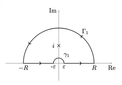

so we introduce the function $f(z) = \frac{\log^4(z)}{1+z^2}$ for $\arg z \in \left(-\frac{\pi}{2}, \frac{3\pi}{2}\right)$ and the integration contour below
$\hskip1.5in$contour1
le $C_1$ the entire contour, using Residue Theorem we got
$$\begin{align*} \oint_{C_1}f(z)dz &= 2\pi i \text{Res}_f(i)\\ &= 2\pi i \frac{(\ln |i| + i )^4}{2i} = \frac{\pi^5}{16} \end{align*}$$
