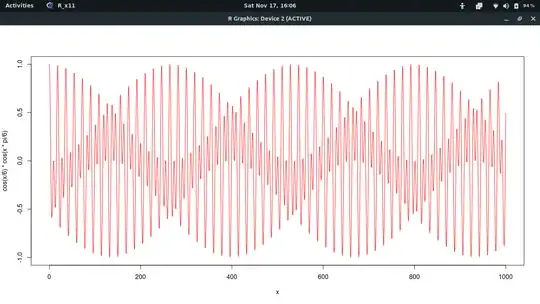

But the graph of the same function looks like this...
The above picture to me appears to be periodic.
Issue : I'm still in a state of confusion because of the result that I calculated above and the graph obtained below. How to resolve this discrepancy?

  • You cannot answer this with a graph. Replace the $\pi$ in your formula with any rational number and it would be periodic but with any irrational number, such as $\pi$, it won't be. However, since you can find rational numbers arbitrarily close to $\pi$, you can get very close approximations which are periodic. If you created that graph with a computer then it will be periodic as you will not have used $\pi$, just a fairly good approximation. Floating point numbers in a point (regardless of the precision) are rational. – badjohn Nov 17 '18 at 10:54

  • Got it. Thanks a lot. So from now on I'll refrain from comparing mathematical results like these with the graphs/results obtained via approximation. – Argon Nov 17 '18 at 11:23

Consider $sin(x) \times sin(3.14159 x)$, what's its period? It's rather large: $628318 \times \pi$. How about $sin(x) \times sin(3.1415926535 x)$?
The point of these examples is that they are close approximations to $sin(x) \times sin(\pi x)$. You would need a very wide or very accurate graph to tell them apart. If your graph was wide enough then you would notice that $sin(x) \times sin(\pi x)$ would drift slowly from these approximations.
Another thing to consider is whether $sin(\pi x)$ could share a zero with $sin(x)$ other than at $x = 0$. It should be obvious that this would only be possible if $\pi$ was rational. However, name any non-zero error margin and it will come within that margin eventually.
Finally note that a computer generated graph, at least one which uses standard floating point arithmetic, will never show this since any value than can be stored in floating point format, regardless of the precision, will be rational. Even if you used some fancy techniques that overcame this, you could still not distinguish the periodic and non-periodic cases without an infinite size and precision graph.
