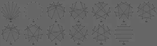

The multiplication graphs for $\mathbb{Z}_p := \mathbb{Z}/p\mathbb{Z}$ (with $p$ prime) visually reveal some basic facts, especially that each non-zero element has an inverse, or – equivalently – that they have no zero divisors, or – equivalently – that $\mathbb{Z}_p$ is a field.
These are the multiplication graphs for $\mathbb{Z}_{13}$:
What they also reveal is that the units $\mathbb{Z}_p^\times$, i.e. the non-zero elements of $\mathbb{Z}_p$, form a group: For each $m \neq 0$ the function $\pi_m: n \mapsto m\cdot n$ is a permutation of $\mathbb{Z}_p^\times$. You see immediately that $\pi_1 = \text{id}$ and that $\pi_{p-1}\pi_{p-1} = \text{id}$. You can also check easily that $\pi_{mn} = \pi_{m}\pi_n$, and that $\pi_{m}\pi_n = \pi_1$ iff $mn \equiv 1\mod p$.

$\pi_2=(\ \ 1\ \ 2\ \ 4\ \ 8\ \ 3\ \ 6\ \ 12\ \ 11\ \ 9\ \ 5\ \ 10\ \ 7\ \ )$
$\pi_3=(\ \ 1\ \ 3\ \ 9\ \ )\ \ (\ \ 2\ \ 6\ \ 5\ \ )\ \ (\ \ 4\ \ 12\ \ 10\ \ )\ \ (\ \ 7\ \ 8\ \ 11\ \ )$
$\pi_4=(\ \ 1\ \ 4\ \ 3\ \ 12\ \ 9\ \ 10\ \ )\ \ (\ \ 2\ \ 8\ \ 6\ \ 11\ \ 5\ \ 7\ \ )\ \ $
$\pi_5=(\ \ 1\ \ 5\ \ 12\ \ 8\ \ )\ \ (\ \ 2\ \ 10\ \ 11\ \ 3\ \ )\ \ (\ \ 4\ \ 7\ \ 9\ \ 6\ \ )$
$\pi_6=(\ \ 1\ \ 6\ \ 10\ \ 8\ \ 9\ \ 2\ \ 12\ \ 7\ \ 3\ \ 5\ \ 4\ \ 11\ \ )\ \ $
$\pi_7=(\ \ 1\ \ 7\ \ 10\ \ 5\ \ 9\ \ 11\ \ 12\ \ 6\ \ 3\ \ 8\ \ 4\ \ 2\ \ )\ \ $
$\pi_8=(\ \ 1\ \ 8\ \ 12\ \ 5\ \ )\ \ (\ \ 2\ \ 3\ \ 11\ \ 10\ \ )\ \ (\ \ 4\ \ 6\ \ 9\ \ 7\ \ )\ \ $
$\pi_9=(\ \ 1\ \ 9\ \ 3\ \ )\ \ (\ \ 2\ \ 5\ \ 6\ \ )\ \ (\ \ 4\ \ 10\ \ 12\ \ )\ \ (\ \ 7\ \ 11\ \ 8\ \ )$
$\pi_{10}=(\ \ 1\ \ 10\ \ 9\ \ 12\ \ 3\ \ 4\ \ )\ \ (\ \ 2\ \ 7\ \ 5\ \ 11\ \ 6\ \ 8\ \ )$
$\pi_{11}=(\ \ 1\ \ 11\ \ 4\ \ 5\ \ 3\ \ 7\ \ 12\ \ 2\ \ 9\ \ 8\ \ 10\ \ 6\ \ )\ \ $
$\pi_{12}=(\ \ 1\ \ 12\ \ )\ \ (\ \ 2\ \ 11\ \ )\ \ (\ \ 3\ \ 10\ \ )\ \ (\ \ 4\ \ 9\ \ )\ \ (\ \ 5\ \ 8\ \ )\ \ (\ \ 6\ \ 7\ \ )$
Note that you can literally see the "cycle structure" of each permutation in the corresponding graph.
Does this specific permutation group have a canonical name?

The group of units of $\mathbb Z_p$ is always cyclic. Hence the $12$-cycles $\pi_2, \pi_6,\pi_7,\pi_{11}$ in your example.
However, no formula is known for finding $g$ such that $\pi_g$ is a $(p-1)$-cycle. Such $g$ are called primitive roots modulo $p$.
In your example, $2,6,7,11$ are the primitive roots modulo $13$.
